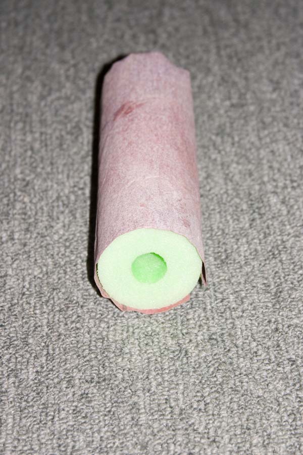

While working on my first Neck, I found it difficult to sand around the curves of the neck expecially between the Nut and Headstock.
I then began to think of what I could use to make this job easier and came up with this:

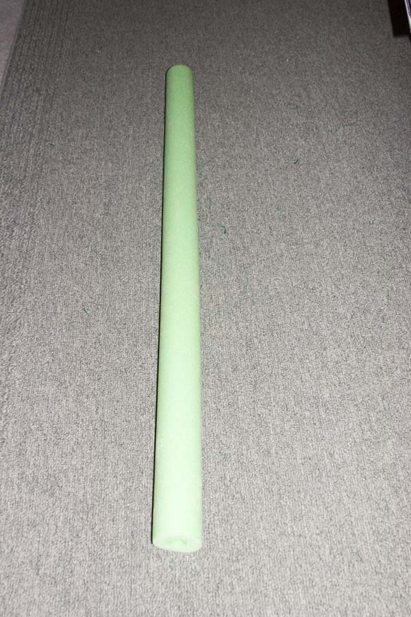

An Everyday "noodle" (The kind kids use in the swimming pool). Cost-About $1.00 at a dollar store or $1.50 at Wal-Mart.
I simply cut off a section to the desired length and wrapped my sandpaper around it and sanded away.
Just wanted to share this with everyone in hopes that someone may find it useful.
Blain

Thanks guys.
I hadn't even thought about using pipe insulation, but that would have been what I was looking for as well.
I like the amount of "give" that the foam has. It makes it harder to sand too much on one spot, but has enough support to get the job done.
Anyways, it sounds like everyone has already found many great alternatives. I'll have to give one of the harder objects, that Ron pointed out, a try and see how I like that.
Blain
http://www.ullrichguitar.com
